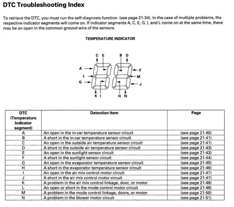

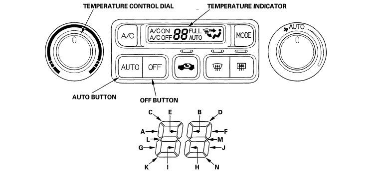

1. The HVAC trouble code retrieval instructions in the Common DIY and Other Info. thread is applicable to the 7th generation Accords (2003-2007). The 6th generation Accords are instructions are slightly different. Since you have Climate Control (automatic and semi-automatic), these are the instructions for climate control trouble code retrieval (not manual A/C) (see attached images).
Climate Control
General Troubleshooting Information
How to Retrieve a DTC
The climate control unit has a self-diagnosis function.
Running the Self-diagnosis Function
1. Turn the ignition switch ON (II).
2. Set the temperature control dial on Max Cool, then slowly to Max Hot.
3. After 1 minute, press the AUTO button and then the OFF button. Continue to hold both buttons down. If there is any abnormality in the system when both buttons are pressed, the temperature indicator will light up the segment (A to N) corresponding to the error. The temperature indicator will then alternate every second between displaying "88" (all segments lit) and the error segment. If there is no abnormality, the segments will not light up.
Resetting the Self-diagnosis Function
Turning the ignition switch OFF will cancel the self-diagnosis function. After completing repair work, run the self-diagnosis function again to make sure that there are no other malfunctions.

This may indicate an issue with the climate control unit, temperature sensors, or air-mix motor control circuit or linkage to the doors.
