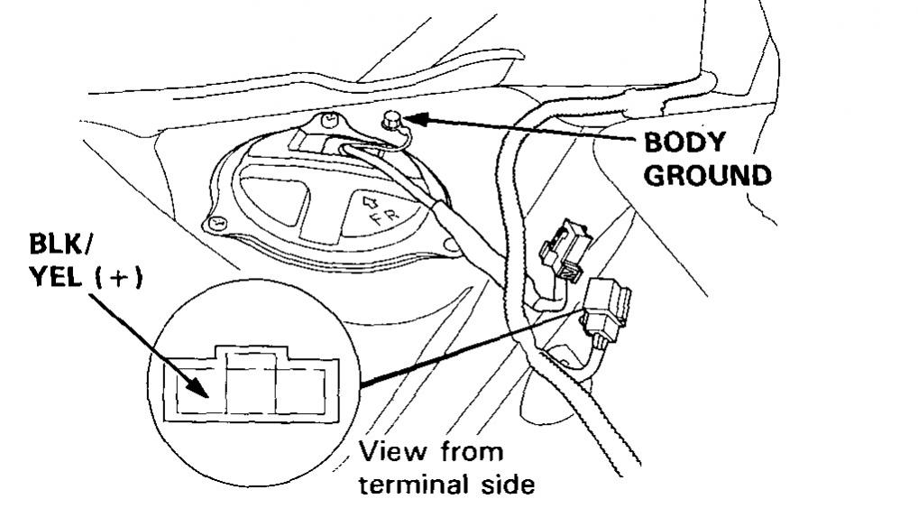

In your trunk (near the back seat), there is an access panel (see pic). Back-probe that blk/yel wire connect one end of a 12V test light to it. Connect the other end to the ground bolt.
A needle will work to back-probe. I found that the mini-clip jumper wires from radio shack work well for back-probing. The copper is thin and sturdy. Just bend the hook straight and remove the spring-loaded plastic cover.
Keep the back seat down, so you can see into the trunk. Turn the key to the II position. If the light turns on for those 2 seconds that you hear the fuel pump prime, and you do not hear the fuel pump, then the fuel pump may be the problem.
