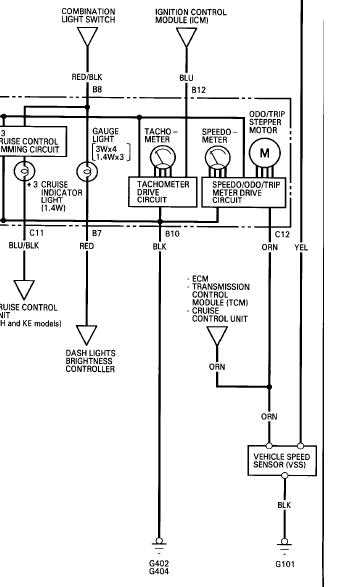

Already cleaned out the VSS part. Still the problem exists.. I'm following step by step from the link above. Not really sure which fuse it's describing. Where is the fuse loacted within the dash..
Old Jul 20, 2012 | 08:29 PM
The only fuse I can think of would be for the ECU.
What readings did you get from the VSS?
EDIT/PS: The VSS is almost right under the inlet to the tb, look straight down at the top of the trans....a three wire connection.
