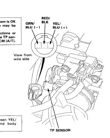

New head installed....do us a favor and tell us the wire colors of the three wires connected to the TPS Sensor.
Old Oct 5, 2012 | 06:35 PM
Ok, I'll give up my GUESS. Too many times after head or intake work the TPS and MAP connectors get connected to the wrong sensor....they are the same size and shape and not that far from each other so @#$* happens.
Look at the wires currently connected to the TPS, if they are not like the pic and the ones on the MAP are....humm, switch the connectors and see what happens

I did actually have that issue with the two sensors. But I ended up twisting the distributor and it made things better. I'm still having an issue with almost no power while trying to leave an intersection, and it once it hits about 4k in the rev range it finally gets some *****...
