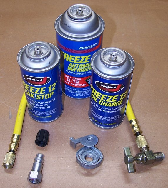

Freeze12 as it comes, ONLY has a fill adapter (the little hose that goes from the refill can-top to the car AC system nipple) that attaches to an R12 nipple (a Schrader, or tire-type valve).
In my case, someone had removed the internal Schrader valve "needles", and threaded on R134a adapter nipples that had their own internal valve needles.
I simply removed the R134a adapter nipple on the low side, exposing the OEM R12 nipple, replaced the internal needle valve, and filled the system with the contents of the Freeze12 conversion kit from Amazon.
I don't know what was in the system - the tech (residential/commercial AC) who sucked it out said he had no way of telling; he just assumed it was 134a for purposes of his recovery sequence.
In the pic below you can see the R134a nipple I removed. Thinking about it now, I should have removed the high side one as well and replaced the OEM valve guts while the system was empty.
Anyway - it's high 90s here, and the AC works fine.

Hey McDesign,
What's the metallic thing front and center in your picture? How many cans or Freeze12 came with the kit?

Nah - let's keep this thread going - I continued this one 'cuz it popped up in a search. That metallic thing clamps on top of the Freeze 12 can, and the right side valve on the yellow hose then threads/pierces from there.
The kit come with 5 cans - oil, leak sealer, and three of Freeze12.
One Freeze12 first, then the oil and sealer, then the other two worked great for me.
Forrest
