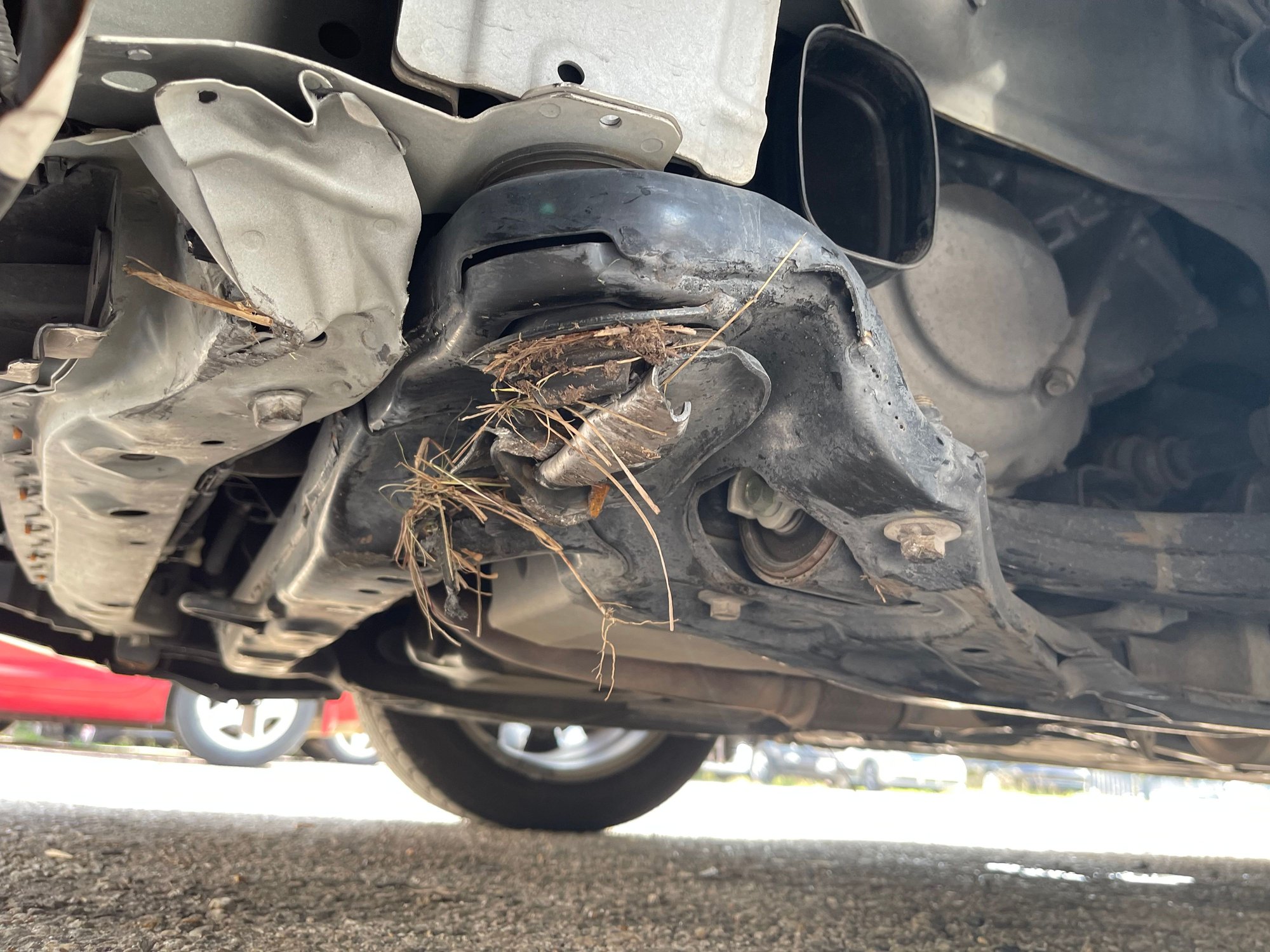

Hello all genius/mechanics on this forum!!!
I am trying to find the right parts for my 2013 Honda Accord Coupe 2.4L CVT. I got lost control and hit a curb side. My undercarriage is damaged, however, I am not sure which parts to order for my mechanic to fix it. Please help me identify the parts in the pictures. The picture is front driver side (left) undercarriage under my bumper left fender. I also missing the air duct connect to the cold air intake filter box, but I could not find the correct one on part online. Please point me to the correct parts. Thank you so much in advance!!!!

I'm having a hard time finding it. I just can't think of the correct name. Try hondapartsnow. I think it might be the Front Underbody Spoiler. But I think it's called something like the mounting bracket were you put the jack under to lift the car up. I'll keep looking.
Hmm. I thought it might be "Fender Brace Support Bracket Steel Left Side" But I don't think that matches either.
Okay I found it it's called
Front sub frame crossmember

Looks like the sub frame that bolts on. The lower radiator support looks bent, but that is welded in place. You may be able to bend back in place.
You'll have to look at the other side to see what normal looks like.

I already got that fix (bended back). Thank you for your input.

Show us the part? If I can take a look at it, maybe we can help you. These guys know parts way better than I. So just show us the part. The part I showed you can be repaired. And I'm sure if you show us what can be repaired. We can help.
