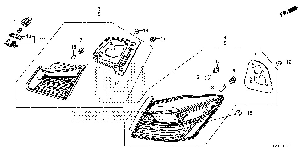

I was replacing my license plate light on my 2016 accord EX and accidentally messed up one of the housings for the license plate light (long story). I've been having trouble tracking the part down. I'm pretty sure it's the same as recent accord gens. Does anyone know the name/number?

Old Sep 27, 2015 | 11:08 AM
If you need #11 (housing) in the parts diagram, it is Honda Part Number: 34105-SNB-003 - Retail price: $5.08.
If you need #12 (lenses, which comes with the gasket), it is Honda Part Number: 34106-SNB-A01 - Retail price: $2.78.
If you order through Honda estore for pick-up at your local dealer, there will be no mark-up over retail, and will probably be less than retail.

Thank you so much! It was 11.
