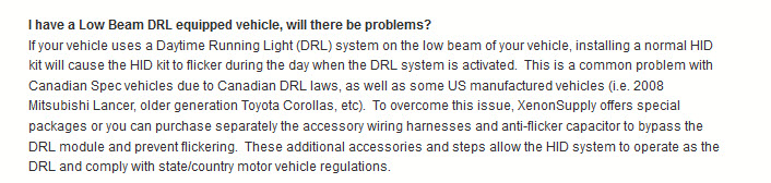

As noted on Xenon Supply website’s FAQ (refer to attached pic.), their anti-flicker capacitor is to bypass the DRL module on cars which use the low beams as DRL.
The 8th generation Accord uses the high beams as DRL, where the MICU comes into play. The 8th gen. Accord does not use a separate DRL module like some older generation Canadian Accords. The MICU may be the source of your right side not turning on. The MICU on the 8th gen. Accords is involved with many other things on the car too; not cheap to replace if it ends up blowing and Honda may not cover due to adding the aftermarket HIDS.
