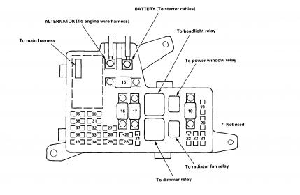

Fuse #39 in the attached pic is the backup/radio fuse and it is 7.5 amps.
If you keep getting code 14 and no ECU codes, then I would say that the ECU is the problem.
