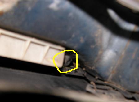

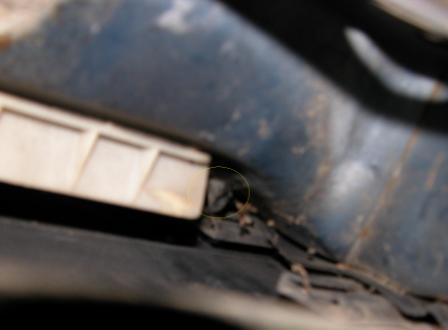

As far as the rear drain(s)-you can get to those from under the car, again use something soft (weed eater line, zip tie, ect) to clean those. The attached-if it works- is a pic of the left/drivers rear drian. I tried to circle it but didn't do so well. Look to the right of the white plastic piece. It's between the side of the plastic fender and the metal body.

The rear two drains, 15 mins for both tops....5~10 of that is finding them but I hope the pic will save most if not all of that. Again, still a 50/50 shot in the rear drains or tail light gaskets causing the water in the trunk.
