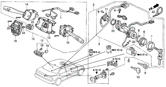

Another way to check the ignition switch is remove the plastic covers from the steering column. The electric part of the switch is #11 in the picture. Opposite from the key & lock-cylinder. Sometimes that switch comes loose (fastening screws #5) but I think it's more common that the electrical contacts inside are just burned or broken. Sometimes they fail to make contact and it's not always caused by wiggling the key.
