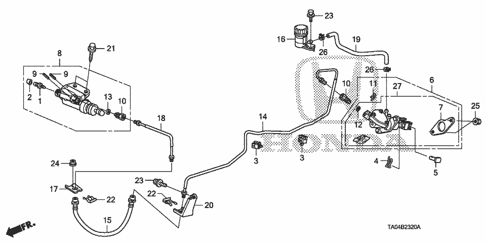

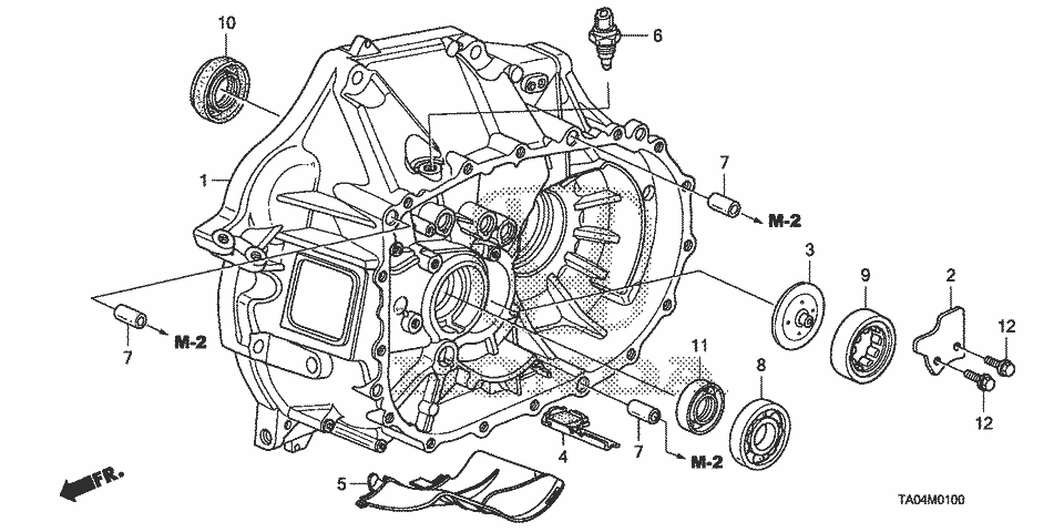

You absolutely can bleed the clutch hydraulic system, and it sounds to me like that's what is needed. There's a bleed screw on the slave cylinder, which is on the front of the clutch case, about mid-height, between the radiator & the engine-trans assembly.
I can only find USA parts drawings, so I hope this is very similar... The 1st shows the clutch case, with a big square hole. That's covered by a rubber boot of some sort, and a lever coming out of it. The 2nd picture shows the clutch slave cylinder as #8, and it's piston pushes against that lever. The bleed screw is #1 on the drawing of the hydraulic system.

Jim, what can I say, you inspired me to search Thanks a lot man!
Here are the pics for my european model (I cannot attach full service manual since the forum doesn't accepts larger files)
