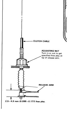

I posted this in another thread by the OP.
Yes it does get "longer" becasue you "tighten the lock nut" towrads the "stopper". I never like to adjust the lock nut except when I first replace the clutch and flywheel. To adjust, I pull on the casing of the cable just a bit and then screw the lock/jam nut in or out depending on where I'm trying to get to.
There should be a small rubber "washer" with a "nub" sticking up between the jam nut and the arm. The "nub" on that rubber washer locks into one of the groves on the jam nut when at rest. That little nub will keep the jam nut from moving - holds it from spinning.
Sorry I go a little over board when it come to the little 3rd gens as I've spent a ton of time with them.....love the little fellas
Attached Thumbnails 1988 Accord clutch or clutch cable issue.-3rd-gen-clutch-adjust.jpg

Yes the cable was adjusted to the farthest 'out' it could go. With the cable disconnected, I pushed the bell crank arm, and it was apparent that all is not well inside. So, she's up on jack stands and I'm beginning to dig in to it. Never done a front wheel drive clutch before, so it'll be interesting. I'll keep you posted...
