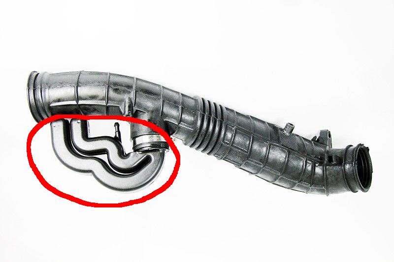

2) what's the purpose of the funny curly part under the air intake hose? my car doesn't have it, the salvage car does, and i need it's hose.

The "funny curly" part is an air baffle to help silence the incoming air to the engine. You can leave it on. It won't hurt anything being in place. You might have to figure out the best way for it to sit.
