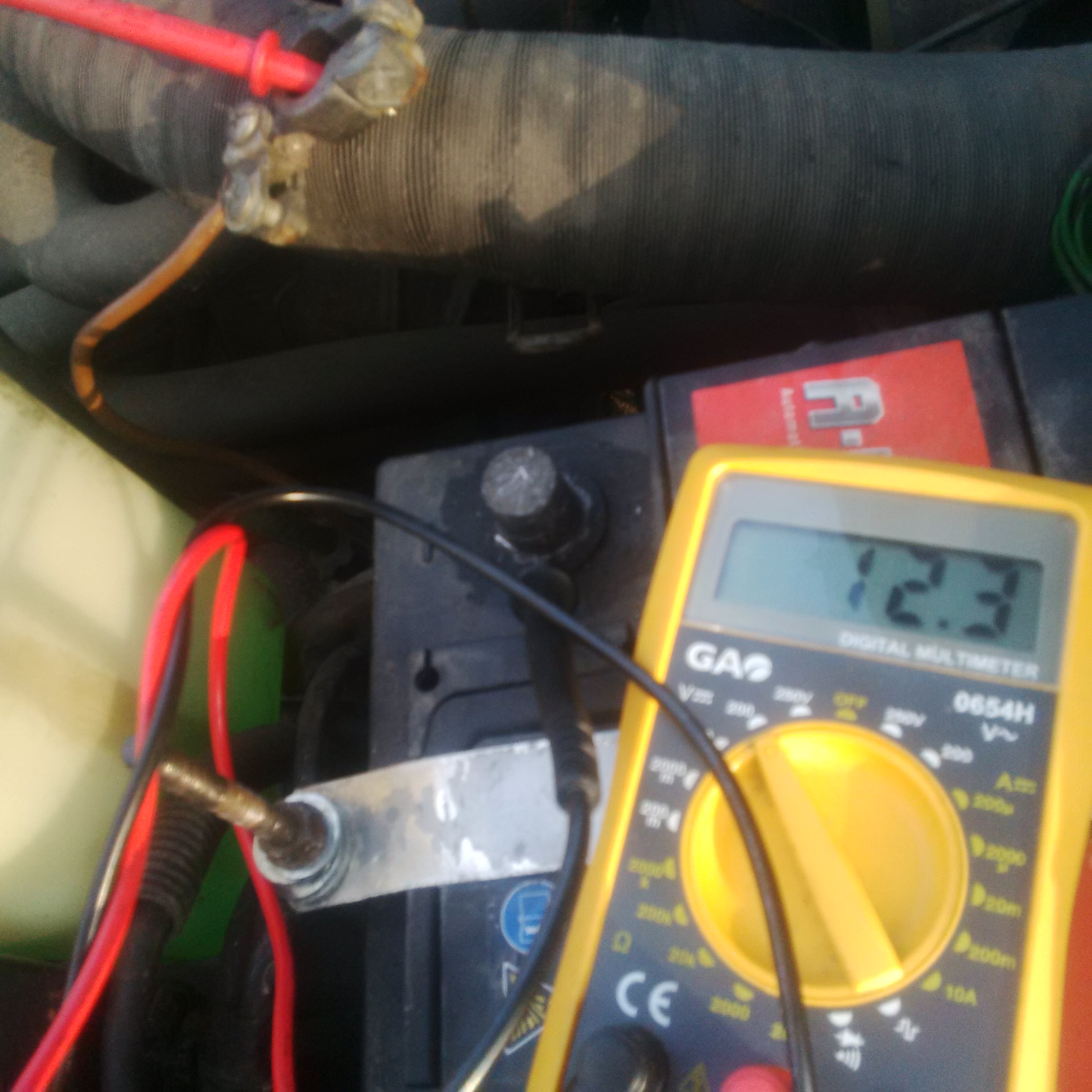

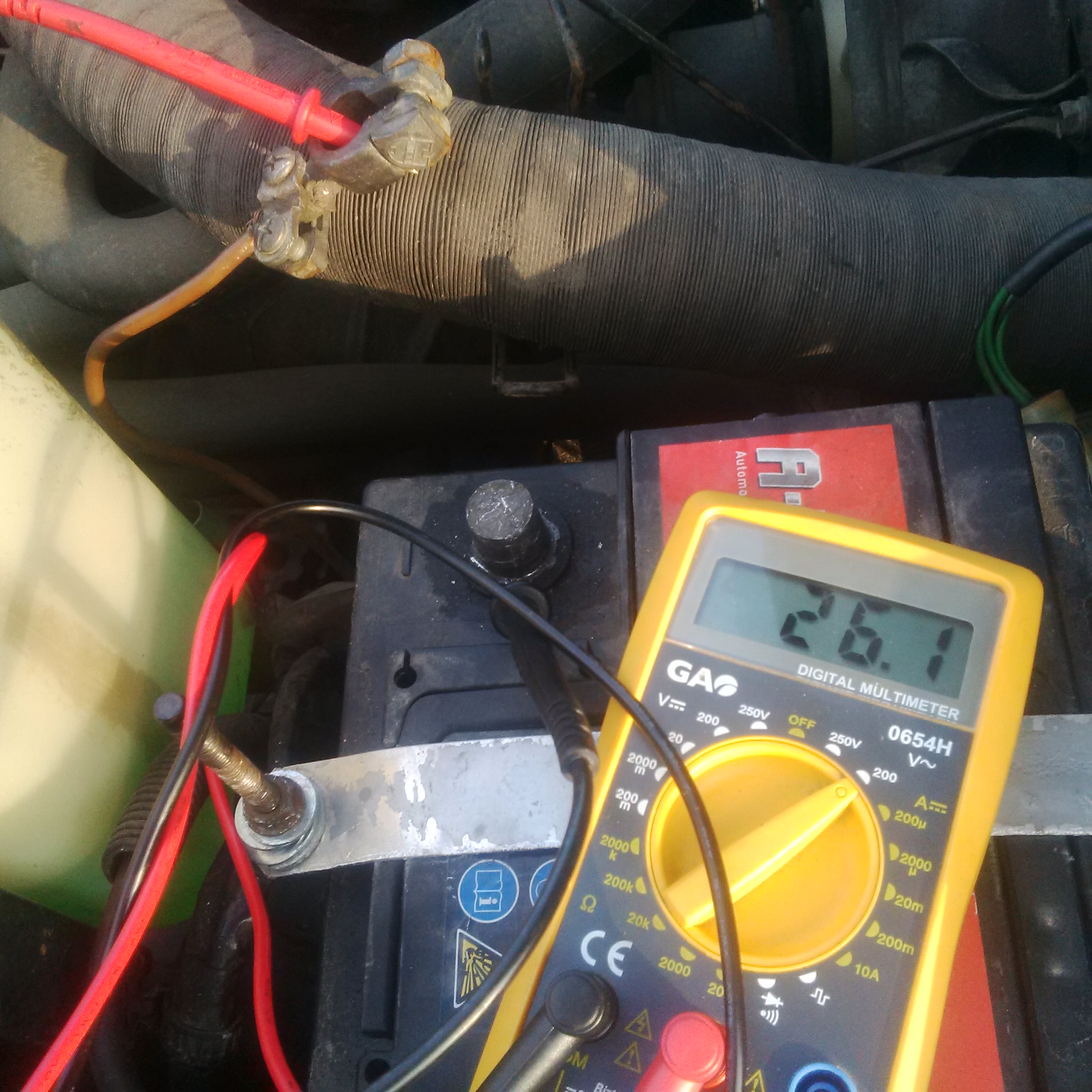

Does that mean my alternator slowly destroying my car electrical system and starts failing...? took my 3 months ols battery out and recharged, batter can NOT be fully charged...charging stopped at first quarter.
AND....check the attachments...
my DMM measuring between the negative pin of battery and the negative chassis of the car 12 VDC and 28 VAC!!?? whaaaaaat??
Okay, I did the testing recommended with a light bulb between the neg battery and chassis negative, pulling out the fuses one by one....the light still on, still measruing the same if ALL the fuses are out!?!? All fuses are OK.

Vac voltage is for alternating current, so ignore that reading. I think your 12V reading is normal, since the voltage will be 12V at the black battery cable when it is unplugged.
The light bulb is measuring amperage and is definitely indicating a current draw. Check that you don't have a light bulb that is constantly on in the trunk or glove box, or that a dome light is turned on with the door open.
If everything is turned off in the car, and you still get an amp draw by that light, disconnect the electrical connections to the alternator and see if the light bulb turns off.
