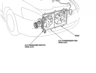

If you can get or buy one (seen some for as little as ~$5) test the AC Pressure switch. Should be continuity on the "pins" of the switch, is there?
Next would be to test for voltage (~5v) on one side of the wires with the car on and the AC on.
Where is the AC pressure switch? sorry bit of a newbie here.
Old Jan 15, 2013 | 07:50 PM
Right/pass side of the cond - low/bottom.
As stated already. If you do not have continuity on the pins on the switch. Either the ac pressure is low or you have a bad switch.
If you have continuity on the pins...we need to do more tests.
Attached Thumbnails Honda Acoord 2003 AC not working-7th-gen-4-cyl-ac-press-switch.jpg

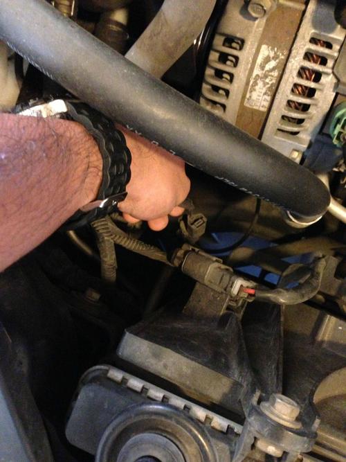

I checked the voltage on the connection right adjacent to the radiator and it gave out 12v

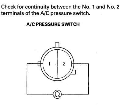

Now test the A/C pressure switch for continuity (as poorman212 stated).
Use a continuity test light, ohmmeter, or multimeter to test for continuity between the pins on the switch.
Attached Thumbnails Honda Acoord 2003 AC not working-ac-pressure-switch-continuity-test.jpg

so i tested both the terminals on the switch using a voltmeter and i got the beeping sounds. which i am assuming it closes the circuit.

I can only assume your "beep" means there is continuity.
Turn the key on and the AC and blower on, measure the voltage on the BLU/RED wire to body ground. What voltage are you getting.
