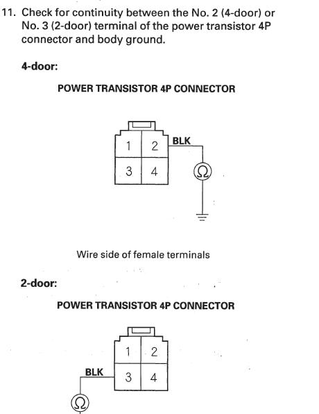

Check for ground on the wires going to the transistor
Old Aug 13, 2012 | 10:40 AM
If you are not getting a good ground to the resistor.
Attached Thumbnails Honda A/C Gurus needed!-misc.jpg
Thanks for all your help, guys! I finally took it in today to the Honda dealership. FYI ... it was what they were calling the "transistor" (resistor). What beats me is, why didn't it work when I got a new one from the parts place and swapped it out? Maybe it wasn't a good ground? Idk. $160 for a cold A/C is a small price to pay in South Louisiana heat! Thanks again!
