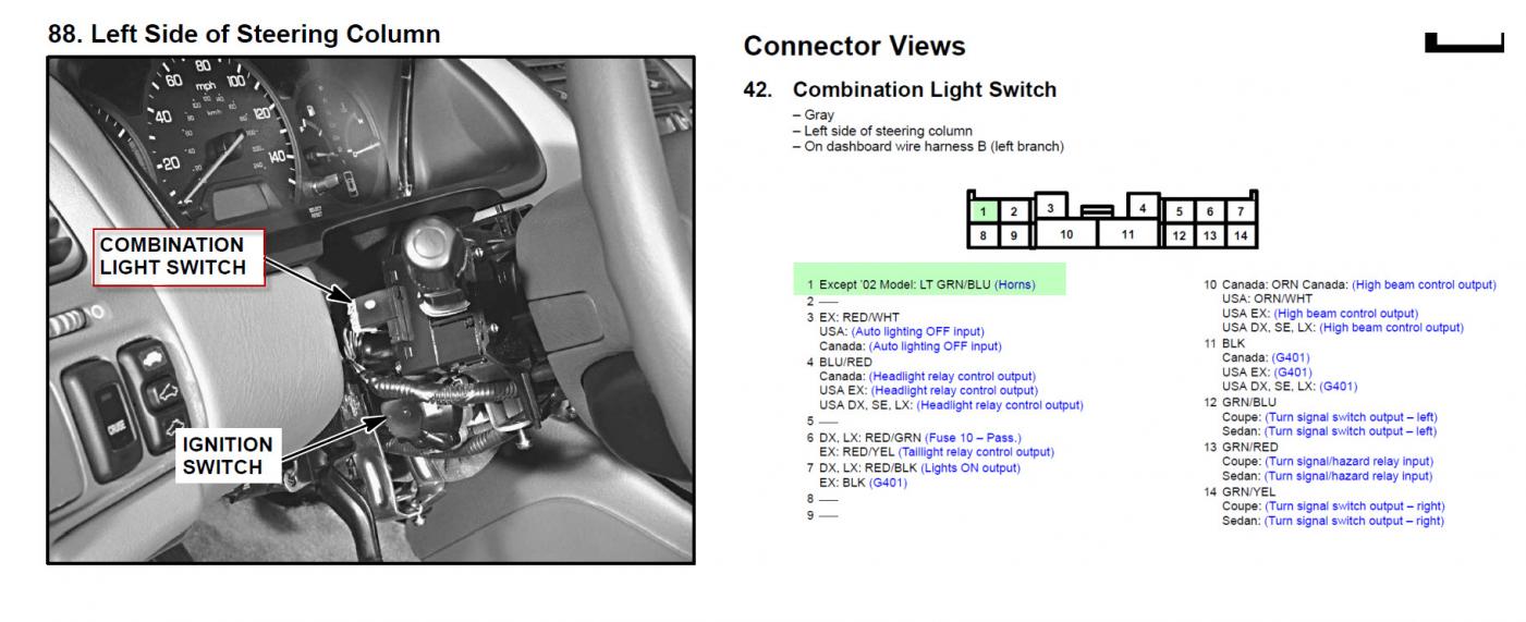

That is true!! Now everybody wants me to do their vehicle...lol. I will more than likely look into those light wires today. Pretty sure instructions call for positive on the lights. I also didn't hook up the horn, would it be too much to ask to point the wire out for me please?
Old Jan 28, 2015 | 11:02 AM
  #22
The horn wire can be accessed at different places, some depending on year and model trim for the 6th generation Accords.
It looks like for your your 2000 EX, one place would be at the 14-P gray connector to the combination light switch.
Terminal no. 1: Light Green/Blu wire (-)
Attached Thumbnails Honda SL3 bypass module-combo-light-switch-connector.jpg

Thank you friend!!!!
