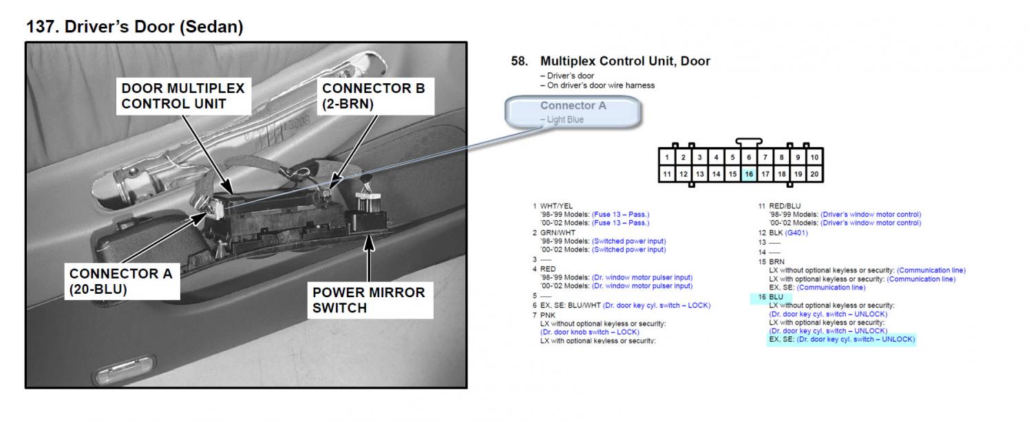

I just looked at some alarm wire references. For an EX, the blue wire at the driver's door key cylinder switch does need to be connected to the aftermarket alarm/remote's "factory alarm disarm" wire.
The blue unlock wire is at terminal no. 16 at Connector A (20-P light blue connector) at the driver's door multiplex control unit (MCU).

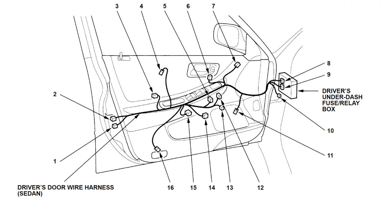

To route the "factory alarm disarm" wire through to the blue wire in the driver's door:
  • Unplug one or more (depending on year and model trim) harness connectors from the driver's side fuse box (this gives more slack and room to route the wire through)
  • pry the rubber boot/cover off at the door jamb
  • fish the wire through the rubber boot and into the door
This other thread by keep_hope_alive for routing new speaker wires shows how to do to route wire, beginning at post #34. It shows the passenger side; however, it is the similar procedures for the driver's side.

The factory alarm arms and disarms with the door on EX models. The alarm can be disarmed at any time by unlocking either door with the key or remote transmitter.
It sounds like the factory alarm may get tripped when you activate the remote starter. It appears the purpose of hooking up that wire is to disarm the factory alarm without unlocking the doors; by giving a negative pulse to the car's blue wire in the driver's door.
See this other wiring guide I found on the web:
http://alarmsellout.com/support/diag...01985-2005.pdf
The blue wire is the unlock wire for the driver's door key cylinder switch that goes to the driver's door multiplex control unit (MCU). Normally when unlocking the door with the key, the key cylinder switch closes and send a ground to the MCU.
It appears the aftermarket alarm is able to disarm the factory alarm without unlocking the doors.
