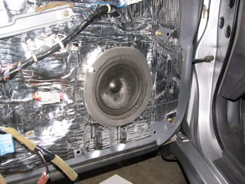

now you can connect the wires and mount the driver. wiring details will follow later, i reused my old connections for now. complete re-wiring of the doors will happen soon.

finished door is sealed and ready to rock

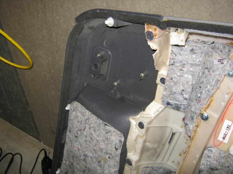

finishing touch, some open cell foam to ensure a good seal between the door and speaker.
