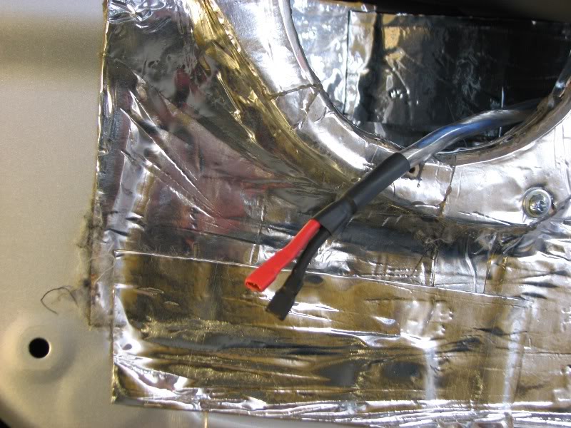

12 AWG wire pulled through factory wire path
12 AWG wire with soldered disconnects and heat shrink

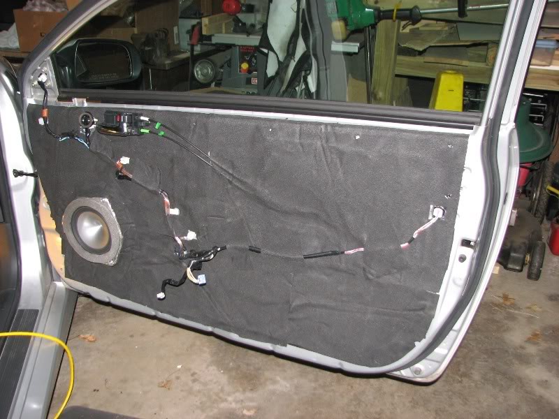

Door with probably 30 square feet of Raammat BXT II
Aluminum sheet metal to cover the hole
With a layer of BXT II on each side and a layer of 1/8" closed cell foam on the inside
for the top hole we also did a layer of BXT II on each side and CCF, here is that metal cut out
Door with holes covered, self-piercing sheet metal screws were used to secure the panels
Door with 1/8" closed cell foam covering all surfaces
Old Apr 19, 2011 | 10:58 AM
  #43
keep_hope_alive's Avatar
Joined: Dec 2009
Posts: 3,279
From: Quad Cities, IL
I spent this past Sunday finishing the doors. For the past few months we had the Mille woofers installed without the holes sealed up (as seen in previous pages). They were powered by the head unit while we finished the amp wiring. They sounded ok (for a $850 speaker set). Now, when those Scion doors close, it sounds like a vault door. rap on the outside and it sounds like concrete. those Mille woofers have a TON of midbass and bass response now. They are now powered by the Audison LRx5.1k:

just some around the speaker doesn't do anything for you. if you want a sound system that gets the most out of the speaker, and doesn't sound like a speaker in a tin can, you need to deaden 100% of the metal. the entire door needs to be deadened and the holes sealed up if you want to get bass out of your door speakers. and eliminate that tin can resonance.
we bought 200 square feet at 1/2 lb per square foot. and not all of it is installed, so less than 100 lbs of deadener. we'll have 100 lbs in the sub, sub enclosure, amp, and amp rack, and speakers anyway. but if a reference quality sound system is your goal, this is how you do it, and you don't worry about the extra weight, it's like having a passenger in the car. if you just want to make noise and not accurately reproduce music, then no deadener is necessary.
that scion has so much low end coming out of the doors, that is shakes the seats, shakes the rear view mirror, etc. no audible rattles thanks to the foam and decoupling. no sub installed yet, but you'd swear there was a sub in the dash. his bass is in his sound stage, centered above the dash as if it was outside the car.
before we added more deadener and sealed up the doors, he had none of that. we had a lot of panel noise from the back wave pressurizing the panel. the extra deadener and seals made a night and day difference.
