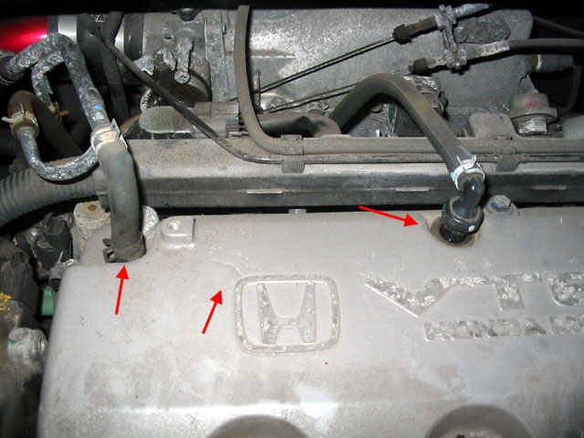

I bought the car last week and immediately drove it on a long trip. No problem for first 200 miles. Suddenly began to run poorly under load - felt like misfiring with a low rhythmic thumping. Immediately stopped to check it out. Found PCV breather (that's the hose that connects the valve cover to the rubber intake tube - left arrow in image below) had become disconnected from the rubber intake tube (connection out of picture frame, top left).
line
(this is not my engine, though is the same)
This breather is also paired with a coolant line (the looped line to the left of the image) It seemed clear that heat had caused it to become disconnected since the rubber nipple that is part of the rubber intake tube was split (and hot). I reconnected the breather to the rubber intake tube with hose tape and shrink tape which seemed to provide a decent, if not very good, seal. I then babied it as I continued, occasionally having a lesser feeling of poor running that could be avoided by feathering throttle. I still managed to get over 34 mpg on the trip.
After reaching my destination, I was able to connect my ScanGuage II, which I didn't have with me before. It displays nearly all any info from computer and I've now been able to monitor intake air temp. It starts at ambient temp. on a cold start, but increases seemlingly in parallel to engine temp. The engine never heats beyond 215F or so, but the intake temp has been indicated at 147F at med. speeds - which is the only time I've felt the engine run poorly since patching the PCV breather. At highways speeds, it settles around 125F. I've driven 500 miles since the patch job (one rushed long trip) and only had the high intake temp after stopping for a bathroom break - it quickly settled back down once I was back up to highway speed.

-pcv breather disconnected from intake tube, seemingly because of heat
-patched pcv breather back to intake tube

-pcv breather may be putting extra hot air into intake. my understanding is that most flow in this breather should be FROM the intake and not TO the intake

(this is not my engine, though is the same)This breather is also paired with a coolant line (the looped line to the left of the image) It seemed clear that heat had caused it to become disconnected since the rubber nipple that is part of the rubber intake tube was split (and hot). I reconnected the breather to the rubber intake tube with hose tape and shrink tape which seemed to provide a decent, if not very good, seal. I then babied it as I continued, occasionally having a lesser feeling of poor running that could be avoided by feathering throttle. I still managed to get over 34 mpg on the trip.
