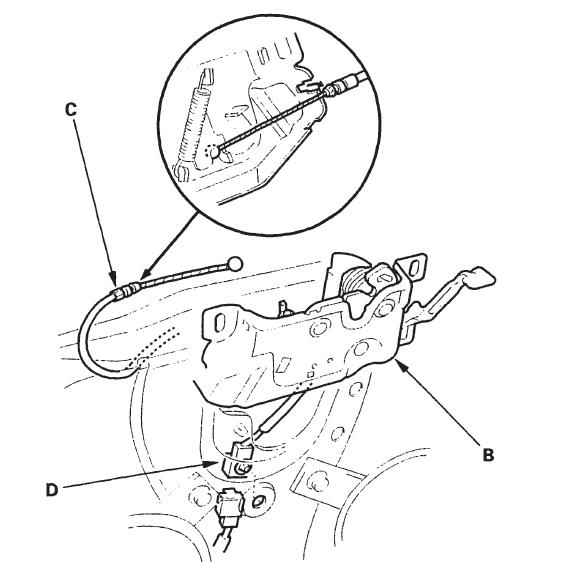

Sorry, I haven't owned a 6th gen (98-02) Accord so I can't give any "first hand" advise on how to get at the two wire switch connector. All I can offer is pic's of it but I'm sure you've seen many of these online.
Attached Thumbnails how to disable the factory security system-6th-gen-hood-latch.jpg

Only the Accord EX trim level has the factory security system. The security system on an EX is part of the Multiplex Integrated Control Unit (MICU). You can't really disable the system without affecting other circuits.
The security hood switch is part of the latch. The way the security hood switch works is when the hood is open, a ground signal is allowed through the switch to the security/multiplex control unit. Normally, when the hood is closed, there should be no ground signal coming from the hood switch. If the hood was closed and the security system sensed a ground signal from the hood switch, it sounds the alarm because it thinks the hood is open.
You may have to first loosen the latch bolts or remove the latch altogether; to reach & disconnect the 2P connector to the hood switch if that was the cause of the false alarms.
Old Jul 2, 2017 | 05:47 PM
Remove the plastic cover held on with a plastic clip, and you should be able to access the 3rd latch bolt or even the 2P connector without removing the latch.
