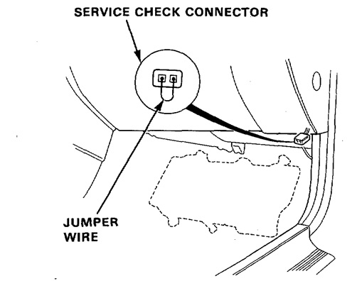

how and where do i short the system to check the codes for the check engine light on a 1992 accord lx 4 door 5 speed
Old Oct 29, 2009 | 05:57 PM
Posts: 16,335

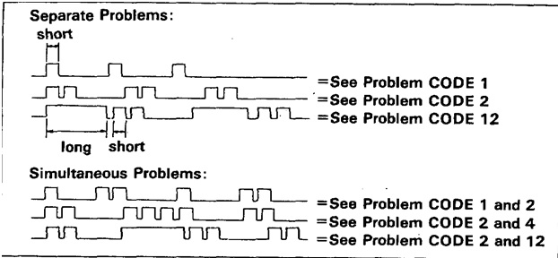

Use a thin paper clip or wire to short blue two pin connector. Turn key to II position. Count check engine light flashes. Long blink =10, short blink =1.
Attached Thumbnails how to get codes on a 92 accord LX-untitled.jpg   how to get codes on a 92 accord LX-untitled1.jpg

6 - Engine Coolant Temperature Sensor
Check wiring and resistance on the sensor. Drain coolant, replace sensor if it is out of spec.
7 - Throttle position sensor.
Check wiring is secure. Also test the sensor.
The TPS is technically not replaceable, and a Honda Dealership will only sell you the entire throttle body which will be expensive. Junkyards are good sources for cheap parts. There are aftermarket sensors out there that you can install. You will have to adjust the sensor so the idle position properly.
