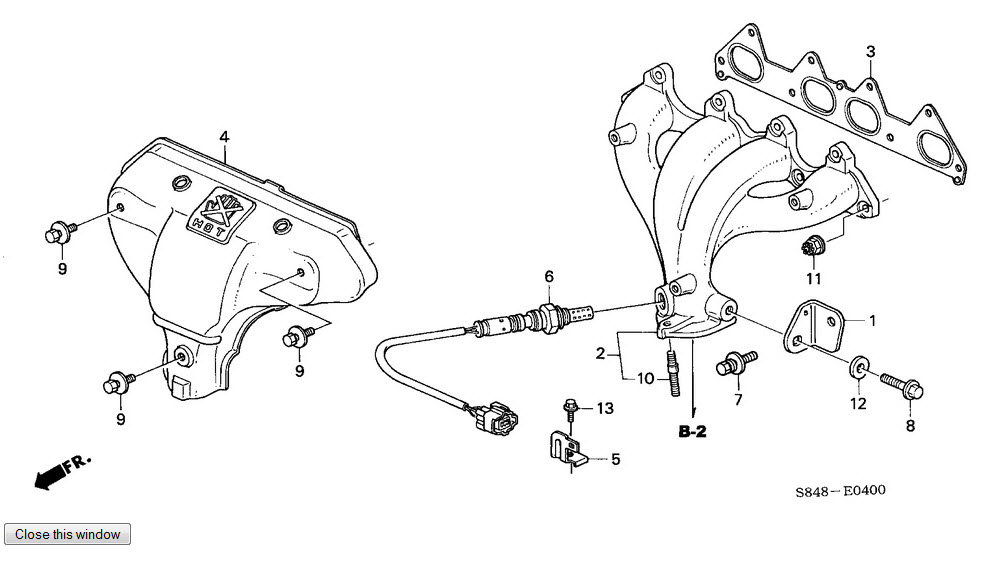

Originally Posted by darkgreen18290
just wondering can this sensor be clean with maybe a carburetor cleaner, and reuse it again. i have 99 accord is it the same location? i dont remember seeing sensor right after the headers.
Here is a thread with some good points of view regarding cleaning an oxygen sensor:
ford-trucks.com/forums/6076-can-you-clean-oxygen-sensor.html
The primary sensor on your 99 Accord (Asia) appears to be on the exhaust manifold, behind the exhaust manifold cover; same as the 99 U.S. Accord. This image is from an international Honda parts site (Ling Honda) for the 99 Accord sold in Asia. I didn't confirm if it was the same F20B engine though.
Attached Thumbnails How to locate 97 Honda LX Primary 02 Sensor?-exhaust-manifold.jpg
