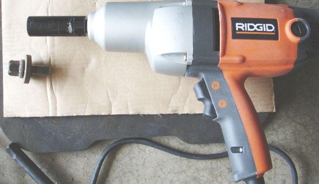

The impact wrench arrived late this afternoon.
It's a rather hefty unit - almost 9 lb - but it's still very usable for removing wheel nuts, etc. I buzzed each lug nut out in about one second - just like you see at the garage.
On to the crank pulley nut.
I used no penetrating oil.
To make a short story even shorter, I started the impact wrench within two seconds of starting my stop watch. The wrench removed the crank pulley bolt in 3 minutes and 36 seconds of continuous banging on the bolt.
I was ecstatic.
The wrench did not seem to mind one bit operating continuously for that length of time.
It was actually quite interesting they way the bolt loosened. Even at 3 minutes and 35 seconds, only one second before the bolt frinally broke free, there was absolutely no indication whatsoever that the bolt was about to loosen. Simply stated, after being subjected to banging and vibration for that length of time, the "something else" finally "gave up", and that was that, and the bolt spun right out lickety-split. There's no other way it can be explained, and I find it remarkable.
The victor and the vanquished:

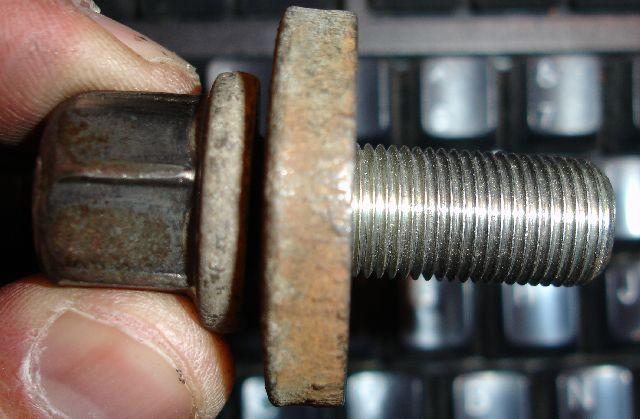

The crank pulley bolt after removal and cleaning with a wire brush:

I think the Ridgid R6300 is a great tool for those who for whatever reason cannot go the pneumaitc-tool route. If this is not the toughest fastener on the car to remove, it must be pretty close and the wrench was able to remove it easily.
It has two impact speeds and there really is quite a noticeable difference in torque between the two as one holds onto the wrench. I think the lower impact rate would be quite appropriate to use on much smaller fasteners, without fear of shearing them off. When you need to bring out the big guns, you just flip onto high speed and, given adequate banging time, any fastener WILL loosen.
