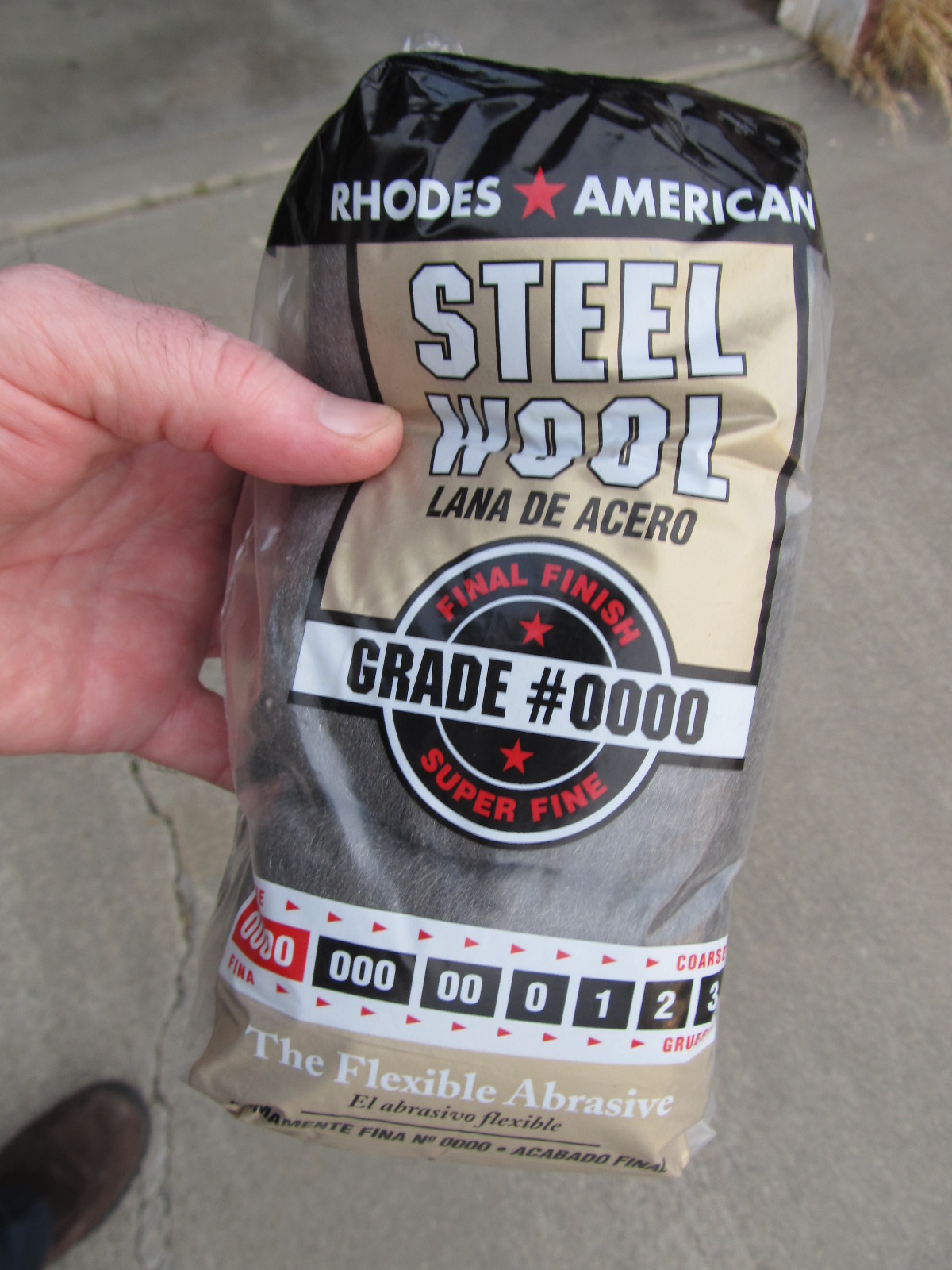

for plastic lens 'clouding' (don't know your car) you can do this yourself using grade 0000 steel wool (finest grade, but cheap) from hardware store.
wet down headlight w/ sponge or spray. swirl motion to steel wool. wet wipe. repeat. 3 minutes. done.
enjoy your car
