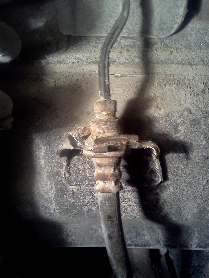

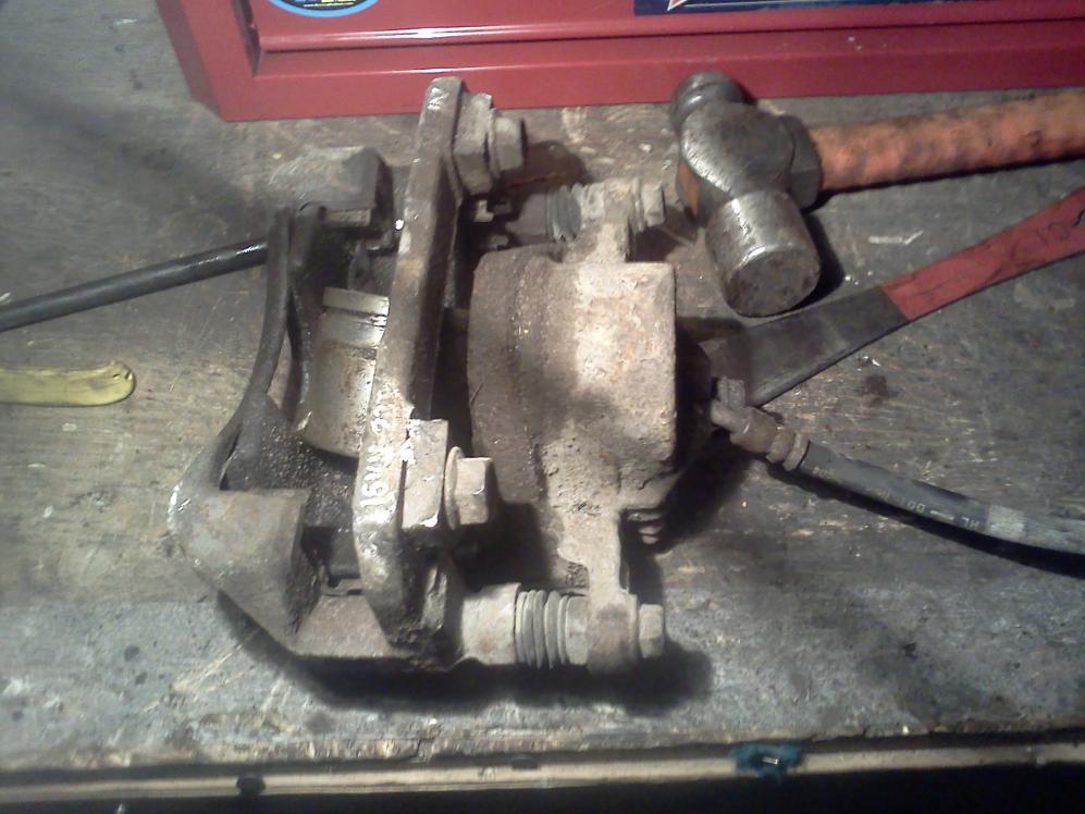

I think upper balljoints are incorporated in the upper control arms & not separately.
Make sure your calipers come with their caliper brackets (if that's what broke). Caliper braket is the part that bolts to the knuckle and holds the slide pins. Not sure if they ALWAYS are included?
Get a line-wrench for the brake lines. Don't know the sizes offhand, but it's easy to round em off with an open-end wrench. Line wrench looks like a box-end wrench with an opening cut through so you can put it over the tube.
Bleeding order is LF - RF - RR - LR. The system bleeds right through the ABS modulator so you don't need to do any separate bleeding for the ABS (like you have to on older Accords).
Don't know ANYTHING about parts suppliers in Canada. Only horror stories about delays & expenses of customs etc crossing the border.

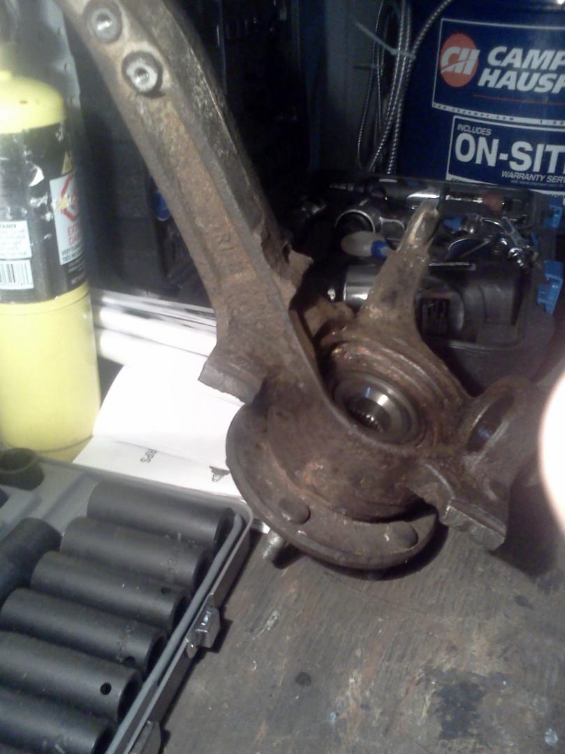

Ive got it all apart and im having a hell of a time removing the wheel bearing from the knucle though, anybody have any tips, and yes i do have a great 60 gall gen with all the accessories, im just trying to save the bearing without wacking it to much, so i can re use it. or, does the knuckle come with a bearing?

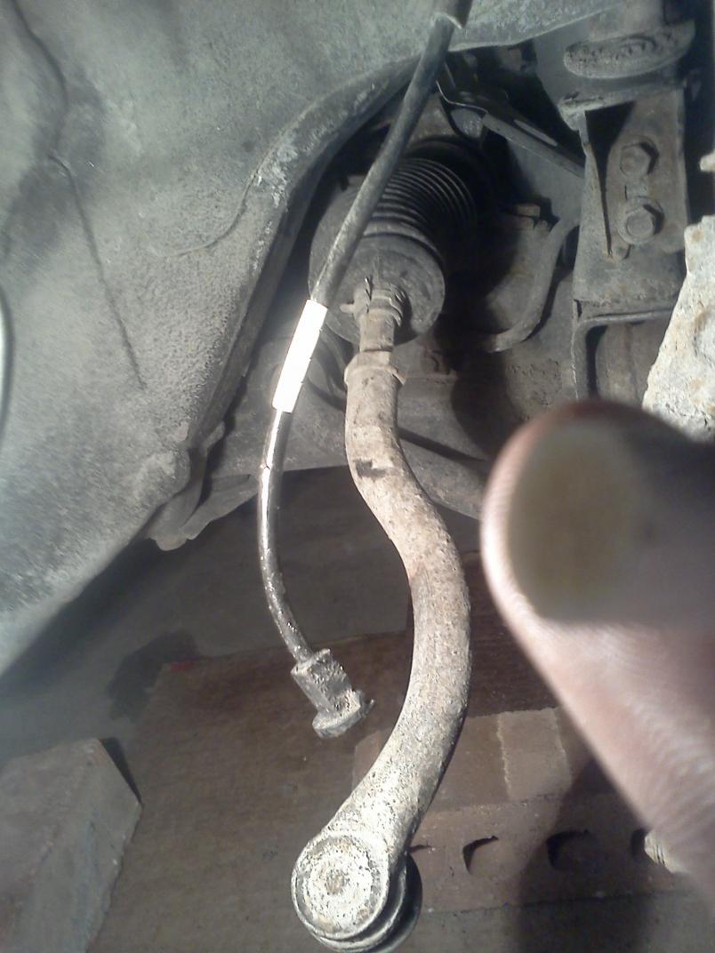

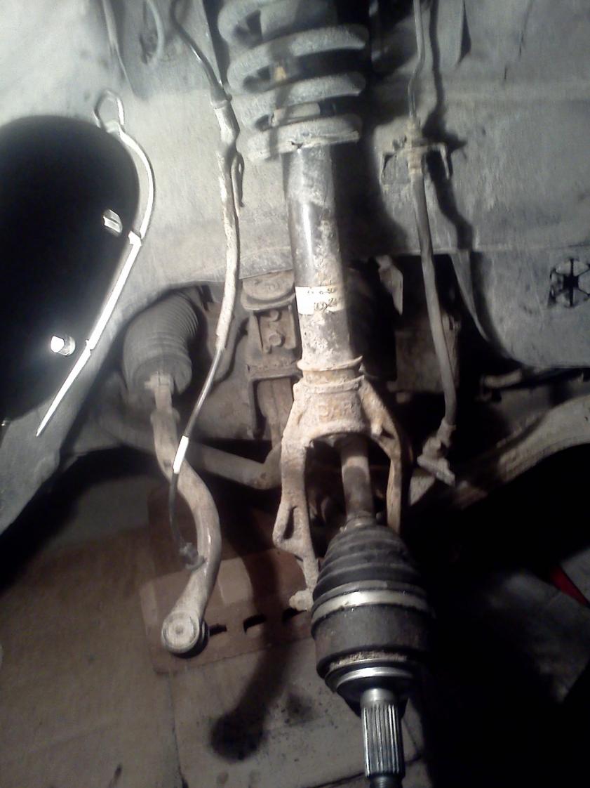

Here are some pictures for any help that you guys have, the brake line needs replacing right at the joiner i have attached a photo of. The bearing needs to be pulled, im just trying to avoid buying a puller lol.
Also, does the abs sensor come as a whole assembly, sensor and wiring or just sensor? ill have to solder a small 2" peice if not, as the abs sensor was corroded in the steering knuckle.
