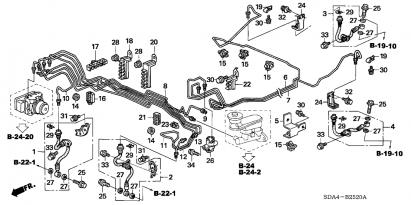

Fifth picture: Soak that whole lump in something better than WD-40. PB-Blaster is good, so it Kroil or Liquid Wrench. After a day of that, use some kind of small pry bar to remove the flat spring clip from the plate in the middle.
I think you're gonna throw away the rubber hose part? That includes most of the steel lump in the middle. Use a line-wrench on the small nut at the top, but you can use a visegrip or something crude on the big part of the fitting. Then straighten the bracket for the new parts.
Inside the box marked #1 in the picture, is the brake hose & attachment stuff.
