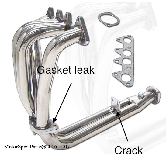

Poorman, I'm uploading a pic now of exactly where the crack is...
Give me 10 minutes max.

Ok here is where the crack is and also where I have a bad/leaky gasket.

Ok, just me but the exhaust is what I thought.
The crack, if you can't find a shop to weld then you'll need to find a replacement....and new gaskets.....you should be good from there. And that is before the O2 so you should see an improvement in the MPG.
