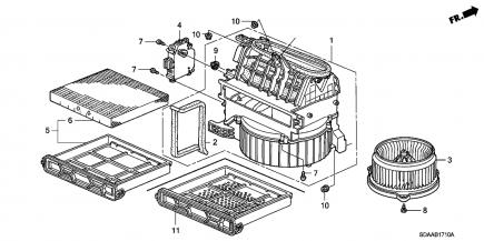

There are a couple of things that I would like to fix in the car. One is replacing the cabin air filter and cleaning the accumulated debris around the air supply. I ordered a new filter and cleaned out the old one as well as I could while I wait for the new one. I would appreciate any tips for cleaning out accumulated leaves, dirt etc. That might mildew of decompose and create funky smells..

I'll look for a parts drawing, but you might be able to remove the blower from out the bottom of the HVAC assembly. That probably get you better access to clean out the crud. You might have to remove the lower dash panel or something above the passengers feet.

Picture of the blower looks like it comes out the bottom directly below the cabin-air filter.
