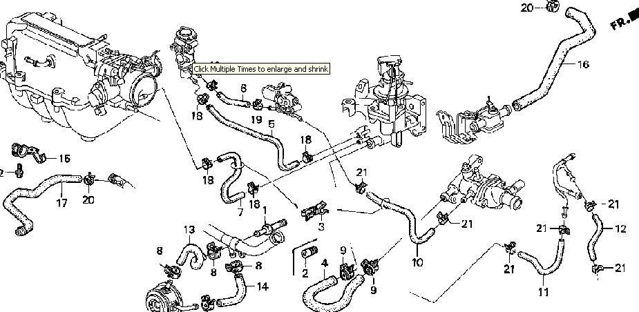

Need to find the leak....sounds large enough that if you refill the rad with water it will pour out of the leak....there are hoses back there, there is a water pipe back there.....So it is hard to "say" what/where the leak is?

There are no hoses where the water is pouring out.
Old May 9, 2013 | 08:33 PM
Ok, can you post a pic or use mine and narrow it down? I really want to help but "I can't see" it.
