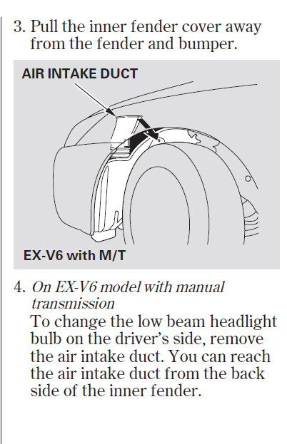

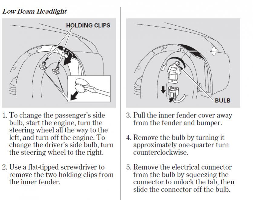

Changing the headlights on your car require turning the steering wheel and partially removing the inner fender to access the bulb. (For coupe V6 with manual transmission, an air duct is also removed for the driver side.
Attached Thumbnails Lightbulb suggestions?-low-beam-1.jpg   Lightbulb suggestions?-low-beam-2.jpg   Lightbulb suggestions?-coupe-v6-manual-transmission.jpg
