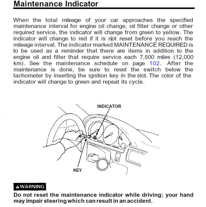

92 accord ex the maintence required square in the lower left of instrutment panel has always been red i think i have seen these green how do u reset it???
Old Jan 18, 2011 | 11:59 AM
Theres a slot in the instrument panel face w/ a button recessed in the slot. Push the button through the slot w/ your key to reset red to green.
Old Jan 18, 2011 | 12:01 PM
^^ Yep.
