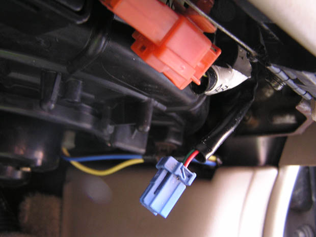

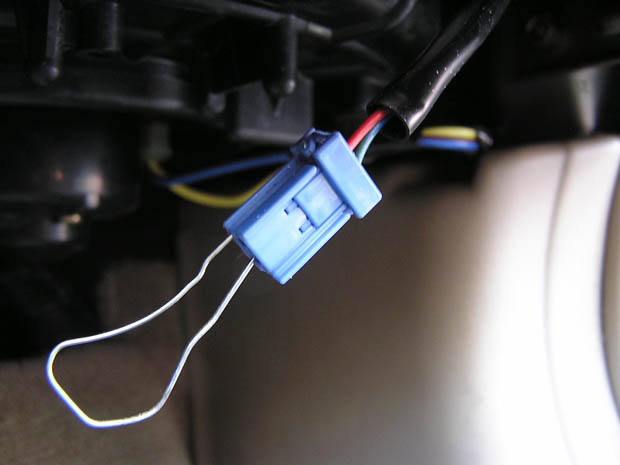

My car does not have 2 blue connectors plugged into another connector as shown in the link under the glove box. Unless the connector shown in the link was moved by the previous owner and left that one blue cable loose there is only one blue connector with 2 wires that was loose and free. No I did not plug a paper clip into the orange connector. I plugged it into the blue connector.
Please advise.

Old Dec 19, 2009 | 03:02 PM
Posts: 16,335
That is the correct connector.
There is only one connector in the 96/97 accords. The other one was changed to an obd2 connection and is behind the ash tray.
Old Dec 21, 2009 | 06:34 AM
Originally Posted by bjr001
Hi,
That's the proper connector. The socket it was supposed to be 'plugged into' isn't really a connector at all. It's just a rubber holder with no electrical connections.
