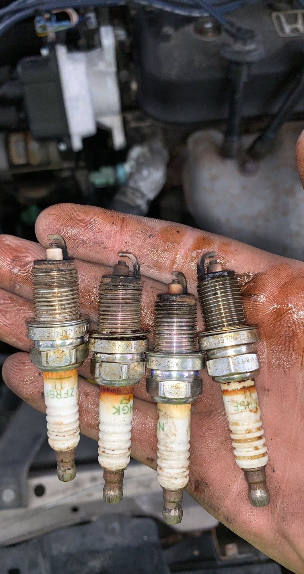

F22a4 91 accord
Runs good until driving around for a couple minutes and it warms up. It sputters, sounds like its running on 3 cylinders, and idles and shakes rough
code 41 cel still there after replacing o2 sensor
