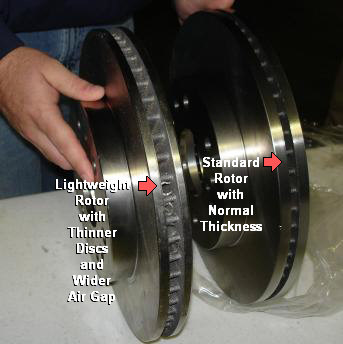

Originally Posted by shipo
One interesting factoid is that while the next generation van was still sporting rotors of the same diameter, they were MUCH thicker (providing a much greater thermal mass).
You may be on to something there...
I have seen the same fitment have differing thicknesses in key areas. Here is a pic I found on the interwebs
Same thickness at outside edges, but more meat where it counted.
Attached Thumbnails Need to replace front rotors after only 8k miles??! advise pls-rotor_warning.jpg
