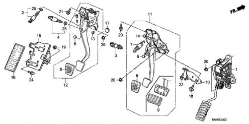

Hi All,
Anyone know where I can get a Accelerator Pedal Positioning Sensor B Module for a 2008 Accord V6?
Old Oct 2, 2013 | 06:07 PM
You could get it from a Honda dealer new or used from ebay or salvage yard.
The APP sensor is part of the accelerator pedal assembly. # 1 in the diagram.

A Google search of the part number 17800-TA0-A01 readily shows new and used (ebay included) from various sources.
If you can find one yourself in a "pick and pull" type salvage yard, it should only take a matter of minutes to remove. Just unplug the 6-P electrical connector, and remove the two mounting nuts from the accelerator pedal assembly.
