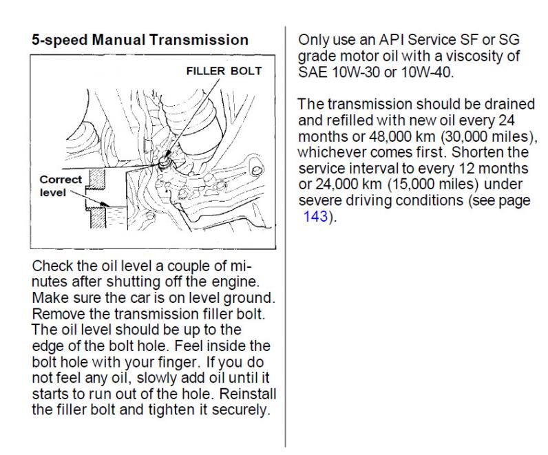

to check the trans fluid you pull the bolt (listed as 14 in the above picture) the opil level should be even with the hole. Make sure to check on level ground.

Also if you are missing the cap over the vent hole buy about a foot of hose that fits onto the vent hole, run it up then bend it back down (upside down U)
The trans needs to be able to vent but you do not want water or dirt to get into the trans.
I would go ahead and drain the trans and fill it with fresh fluid.

Here is info. regarding checking transmission fluid on the 5-speed from the owner's manual.
