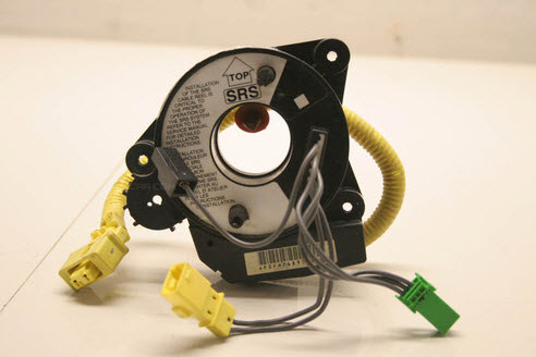

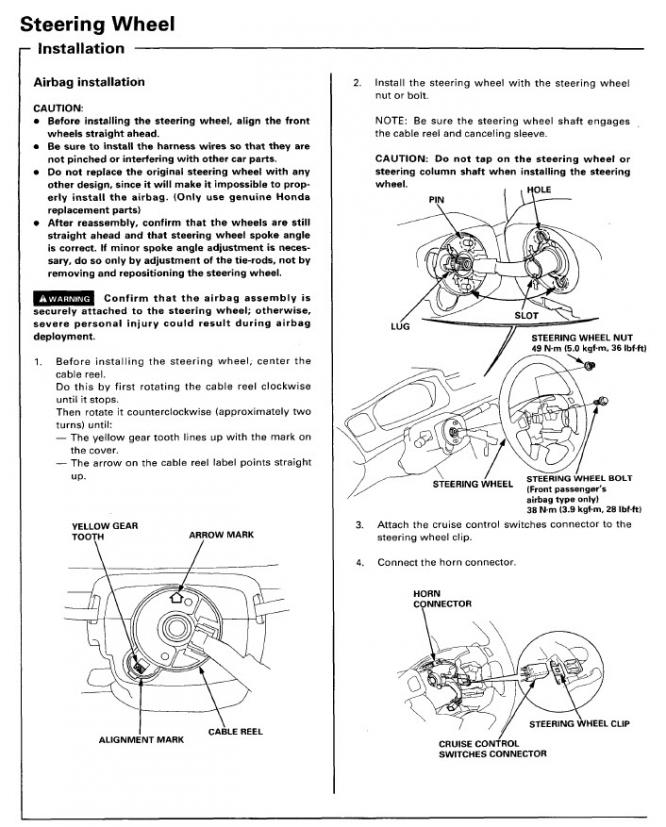

what does this cable reel/clock spring do, connect to, etc?
Old May 2, 2012 | 07:54 PM
  #25
A cable reel also known as a clock spring is located behind the steering wheel.
Per wiki:
"A clockspring or clock spring is a special rotary electrical connector which allows a vehicle's steering wheel to turn while still making an electrical connection between the steering wheel airbag and/or the vehicle's horn and other devices and the vehicle's electrical systems. The clockspring is located between the steering wheel and the steering column."
See picture of cable and installation instructions.
Attached Thumbnails New to honda-cable-reel.jpg   New to honda-cable-reel-installation.jpg
