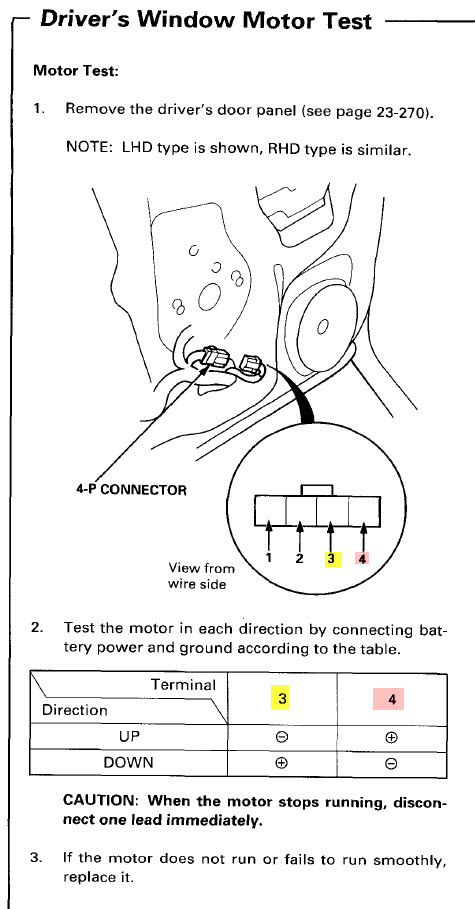

1. Sound like a bad window regulator. The window regulator/motor is replaced as an assembly, if it is bad. It is not hard to do if that is the case.
2. To test the motor (I will assume this is the driver's side), apply direct 12 volt battery power and ground to the motor side. Positive (+) to terminal No. 4 and negative (-) to terminal No. 3. to try to raise the glass. See attached image.
You can use some long speaker wire to run to the car battery if you do not have a separate 12 volt power source. Be very careful when connecting wires at the car battery to not touch any positive to negative. (Do not let the wires you're using to do the test touch together.)
