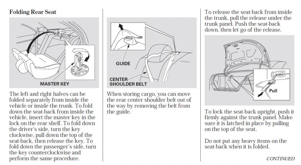

Have you tried it with the key?
Attached Thumbnails New ride 2004 Accord EX Coupe minor problems-rear-seat.jpg
