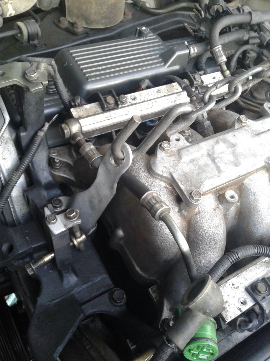

Lift point
Squished and cut fuel hose

Thoughts?

I don't have a V-6 so I don't know how the steel line is fastened below the view in this photo.
Does it need the flexibility of a hose to handle vibration & movement of the engine inside the engine-bay? It doesn't look like a long-enough hose to accommodate movement of the engine; but maybe it's still needed for thermal expansion of everything between the fuel-rail and wherever the next bracket is located?

it just leads to the other fuel rail and is connected the same way on both ends
two posts up, it shows entire line, but the end is blocked by the alternator wire. but its the same as the other end, not sure why its odd shaped and more steel on one end, perhaps because it snakes behind the power steering pump and alternator

So maybe it's more about assembly tolerances & what order the stuff is installed at the factory?
Don't make it 1 direct straight line, because then it won't accommodate thermal expansion of the engine.

Do you think there is a reason the rubber hose is so much bigger than the metal line?
I strongly suspect the inner diameter of both are roughly the same.
I was thinking the same thing. We'll find out when I cut the sucker apart.
