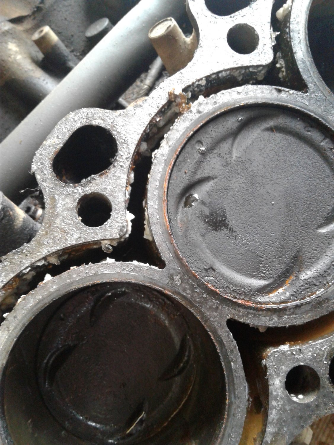

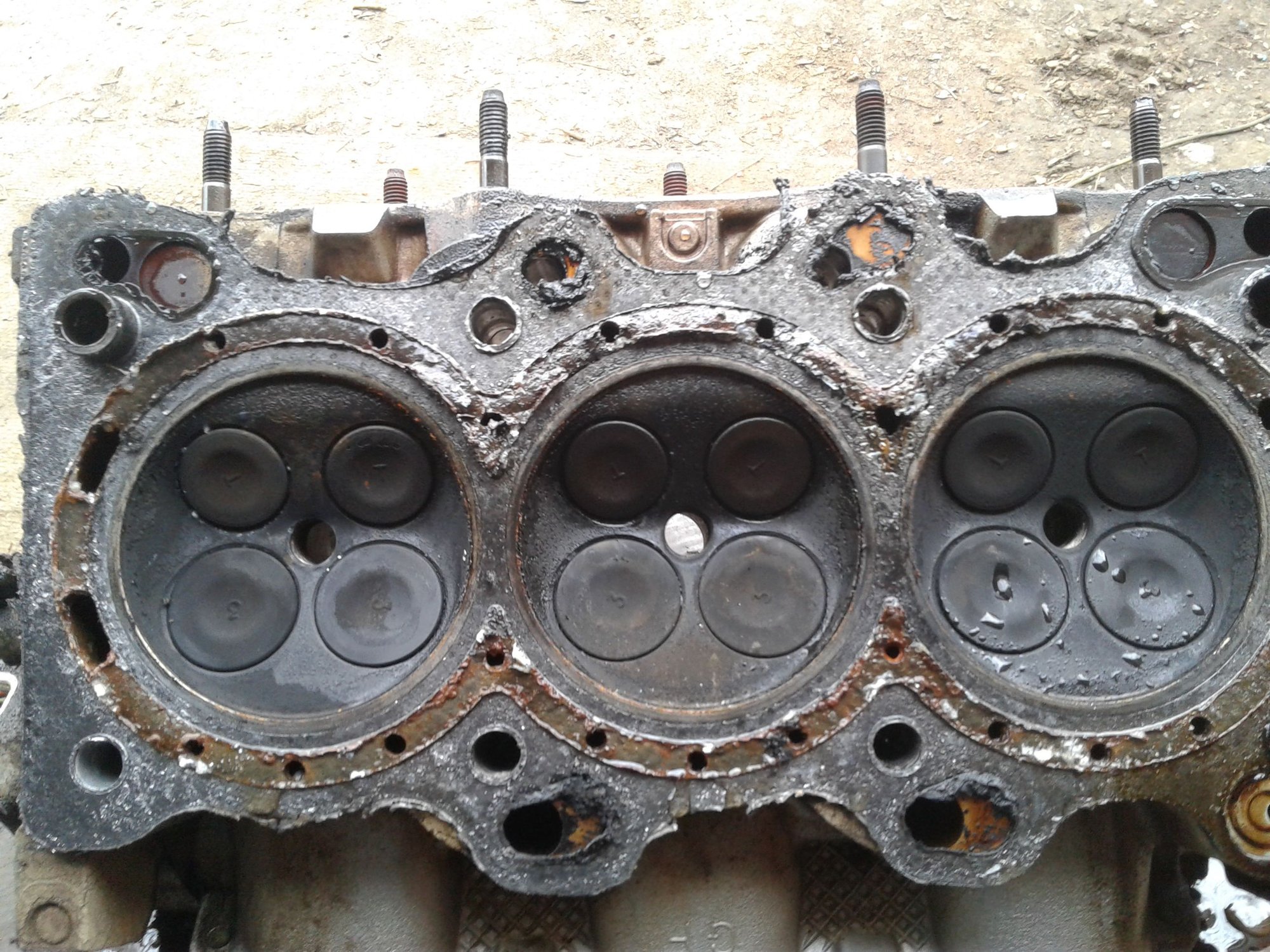

Whats this white gunk? I can roll it between my fingers and it disolves

Head gasket

The white gunk is typically from one or more of the following:
  • Use of incompatible coolants.
  • Waiting too long before flushing out exhausted coolant.
  • Use of stop-leak products.

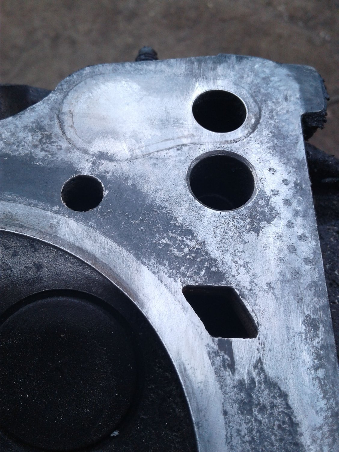

Pit marks, can it be fixed?
Is that my marker to how far it can be milled down?
