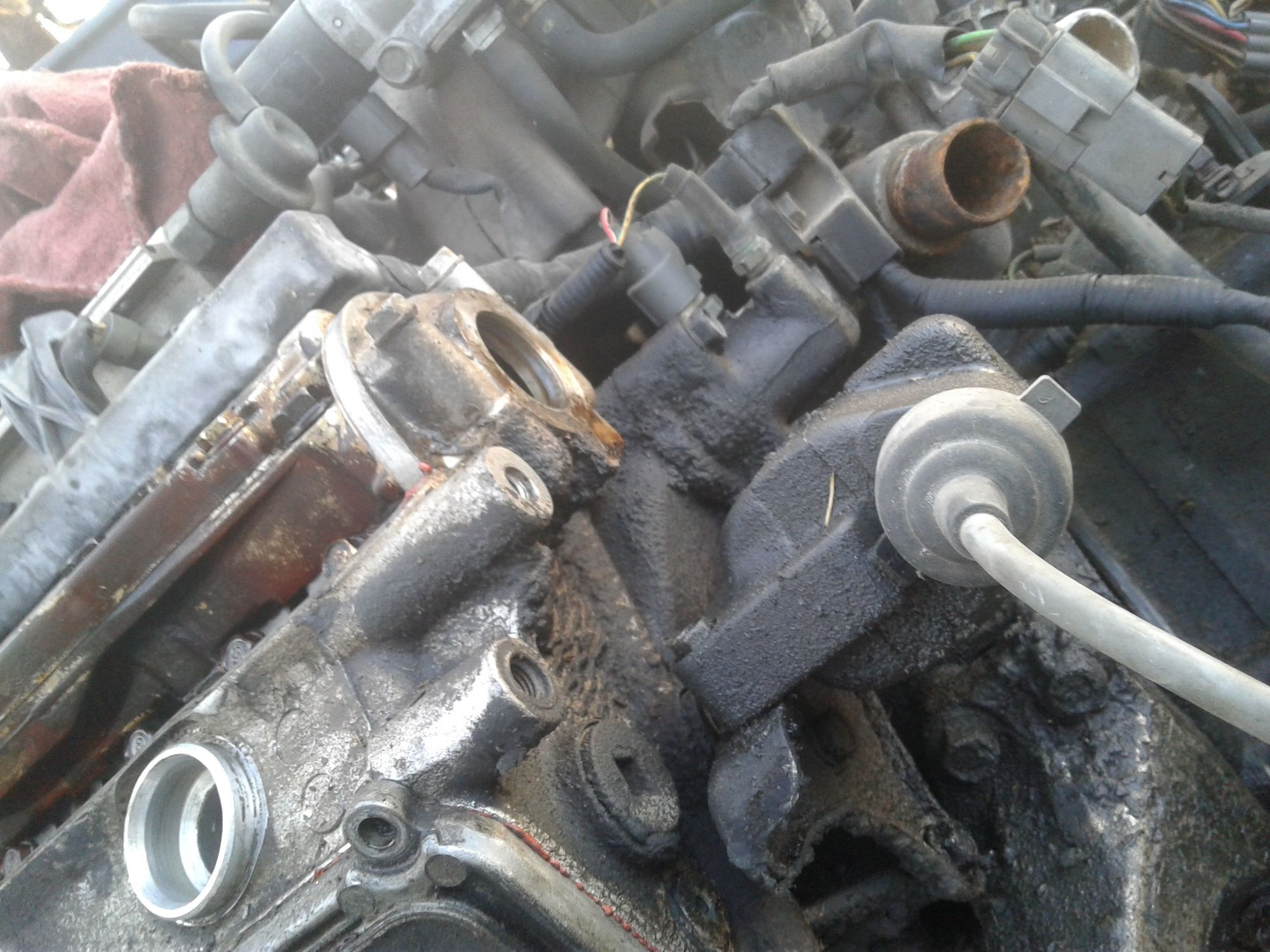

I think it was leaking from the distributor
