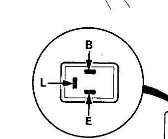

I don't have a wiring diagram for the 89 accord.
The hazard relay is the same between your 89 and my old 95 accord, so the inputs will be the same.
You will need a volt meter. Unplug the hazard/turn signal relay. It should have three pins labeled L, B, and E in the picture attached. You want to test the proper pins on the fuse box.
E should be a closed circuit to ground (zero resistance).
With the key in the II position, and car not running:
B should have voltage when the hazard switch is turned on and turned off.
Let us know what you find.

Kerby- If the relay checks out you will then you'll want to move to the combination switch and test it. Again be sure all fuses are good-underhood(? can remember, will check later) and under dash
