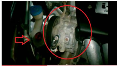

Is the noise coming from the PS pump or the alternator? I took a snapshot of your video. I circled the PS pump. Ignore the arrow, because I thought that this noise just showed up after you changed the coolant.

Oh, it's definitely coming from that pump you circled, but it seems like it's the belt it's attached to that is making the noise... I the thought it was the alternator because of this video:
youtube.com/watch?v=ynph4KDSzQE
So what does this pump do, and is it expensive?

Get some belt dressing & spray it on the belt. If that makes it quiet, then it's belt-noise, not really a bad power-steering pump.
IF that's the case, the belt dressing is only temporary. Get a new belt. They get hard & slippery with heat & age.
About the oil change interval... Just in case it's related to timing-chain noise, you should probably change oil more often than 10k miles for awhile. When you drain it, stick a coathanger in the drain plug & root around in the oil pan - looking for chunks of sludge. Hope you don't find any...
