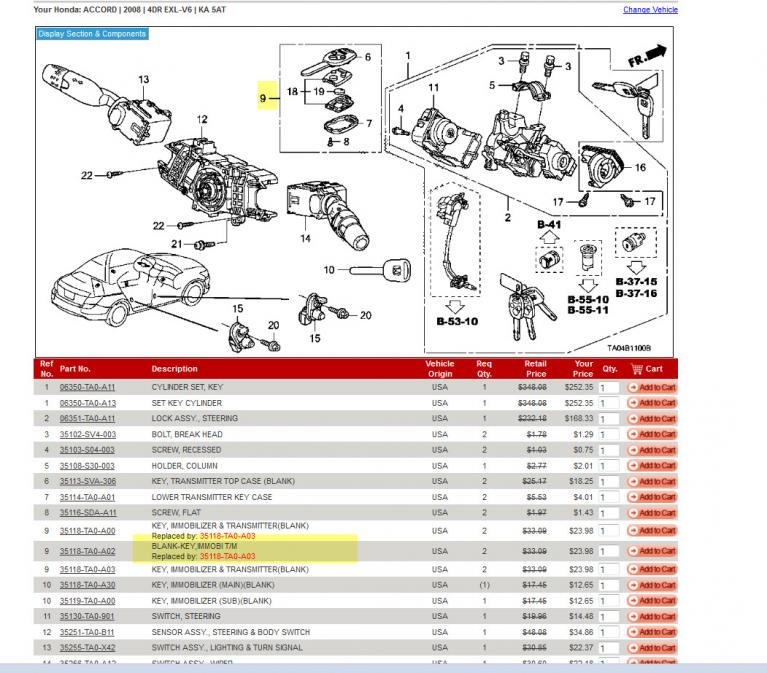

A1) Regarding the key blank, get the latest genuine Honda one with revised transmitter; Honda part number 35118-TA0-A03. There were earlier versions; however, due to the keyless remote having problems, revisions were made to the transmitter. The Honda list price is $33.09, internet Honda dealer discount price is around $23.98 plus shipping.(See attached pic. regarding key blank w/transmitter.) -- Various internet Honda parts dealer like Bernardi Honda Parts, Majestic Honda, Honda Parts Now, etc.
See this link for Honda TSB 09-099 regarding the revised transmitter. Note that the TSB is regarding only replacement of the remote transmitter unit inside the key blank/transmitter assembly. Since you need/want the whole key blank/transmitter assembly, the part number I shown above is currently the latest.

Attached Thumbnails Newbie from NJ - 2008 Accord EX-L V6-key-blank-transmitter.jpg
