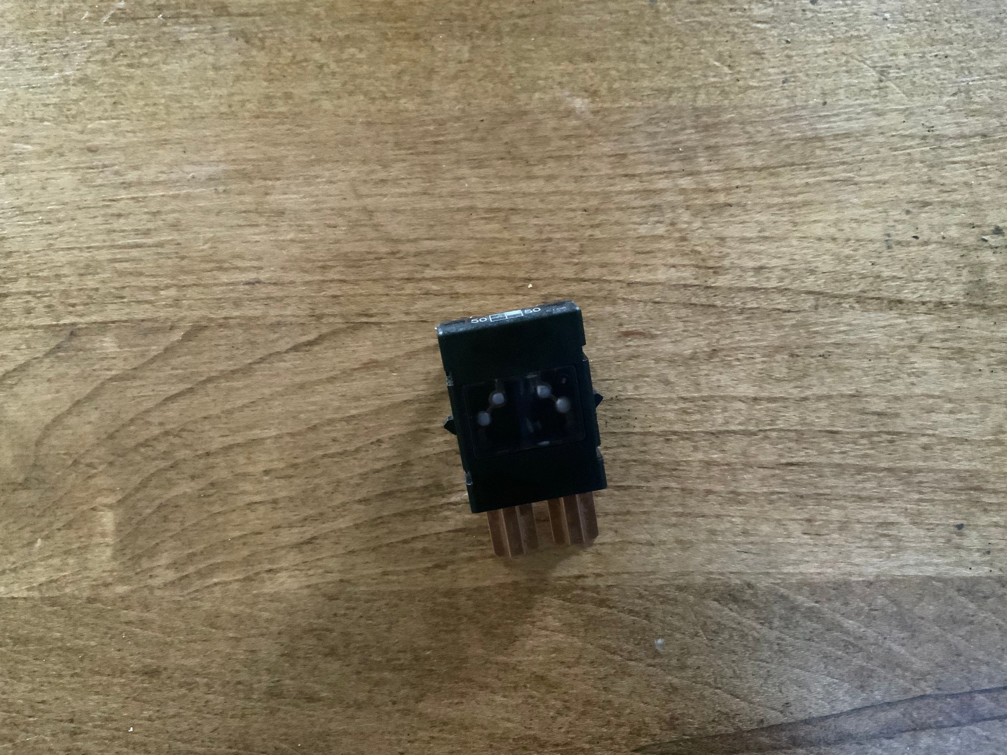

Do these look good?

Those don't look like fuses. They might be relays. I can't quite tell from that angle. Where did you pull them from?
