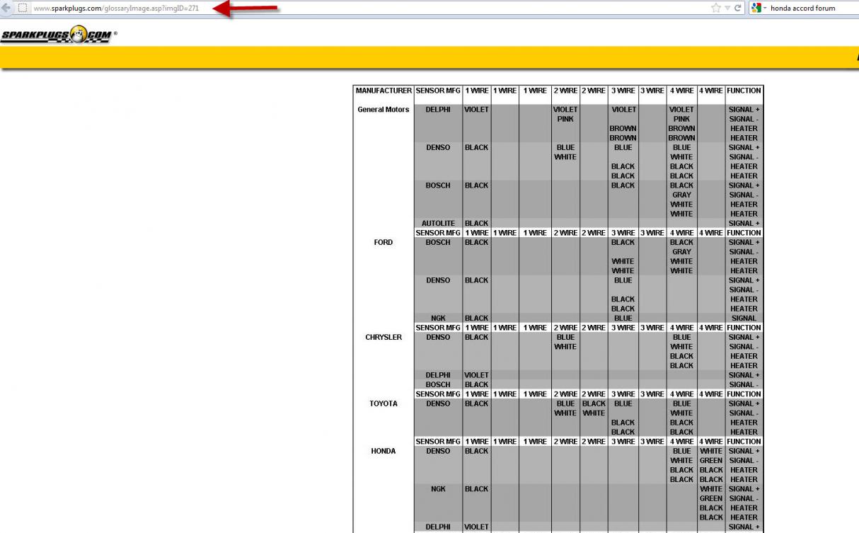

Just in case your O2 wire colors are different, here is a cross-reference and splicing guide.
"http://www.sparkplugs.com/glossaryImage.asp?imgID=271"
"http://www.sparkplugs.com/sparkplug411.asp?kw=Universal+O2+Sensor+Installati on+Instructions&mfid=0"

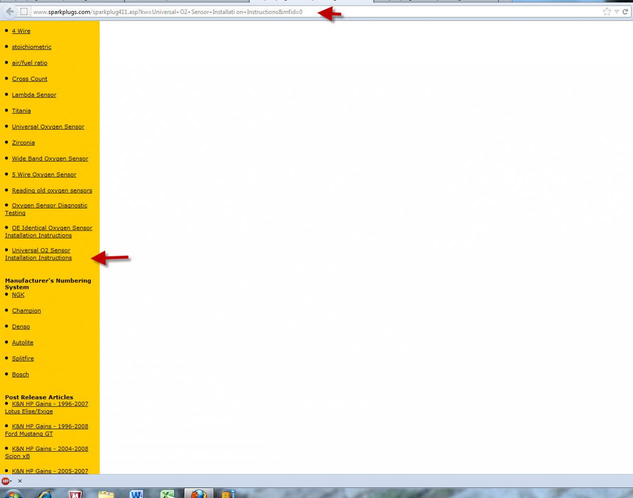

Sorry, I stepped out for a while.
Every time I paste that site's direct link, it redirects. So, I added the quotation marks. Copy and paste the link address without the quotation marks (" ").
See my attached images or the screenshots. The second link will redirect; but, then go to the area I marked in the image.
Let me know if you can get it to work.
